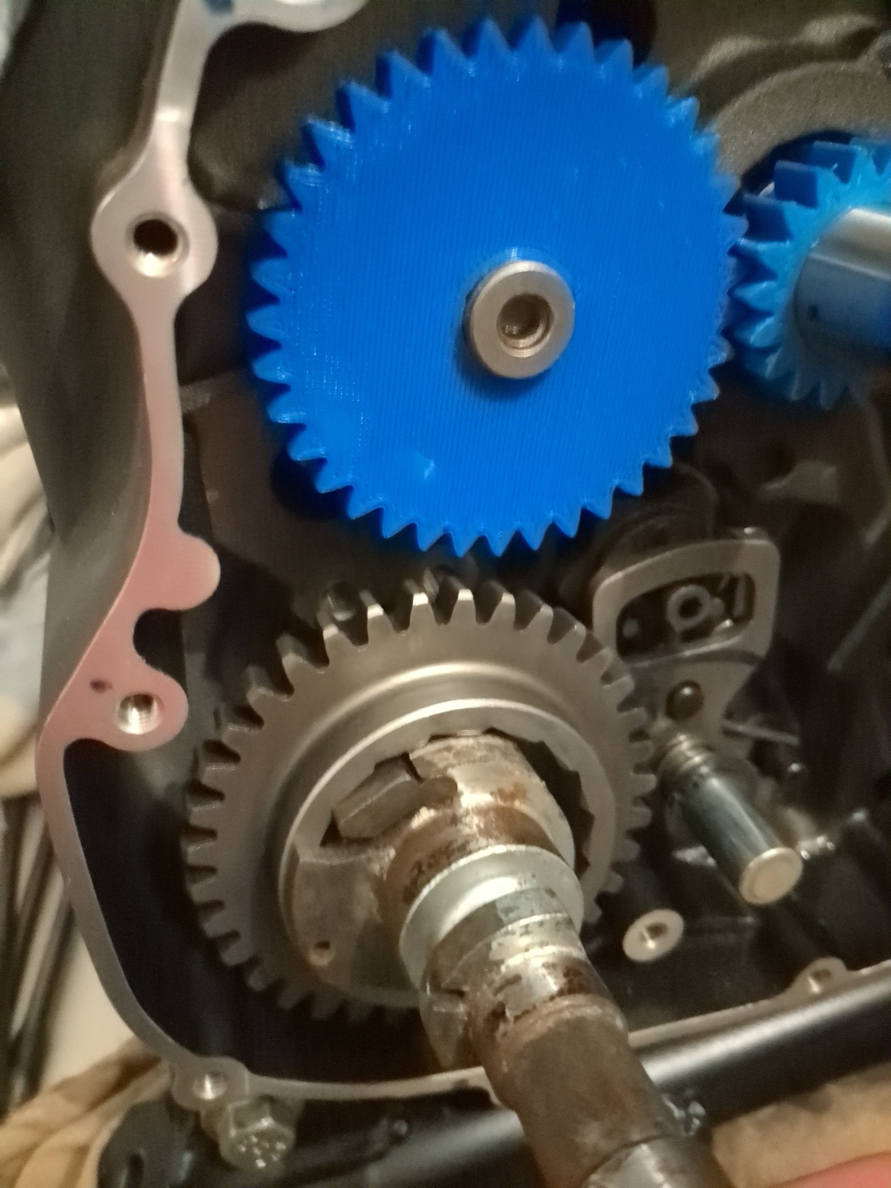

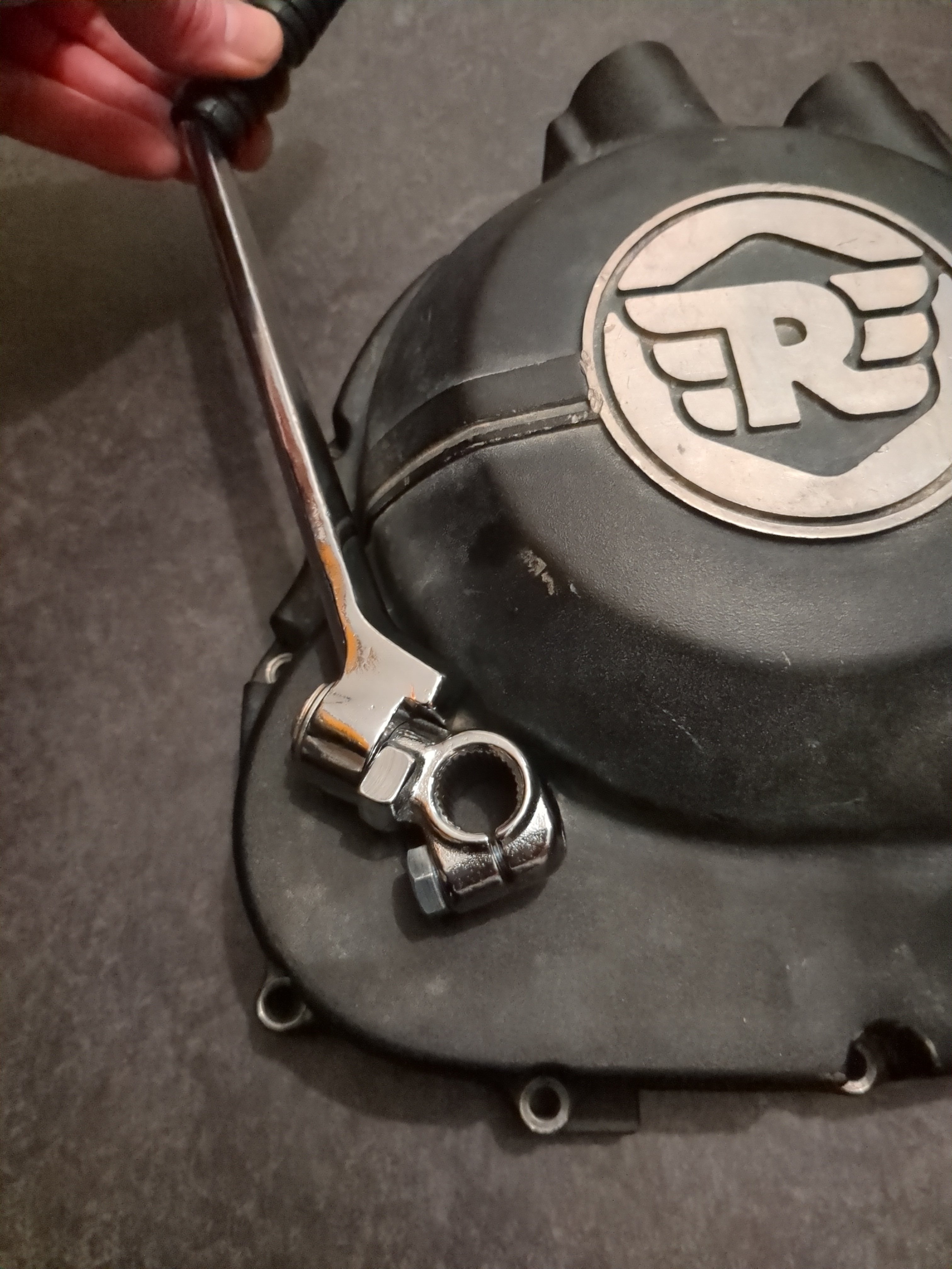

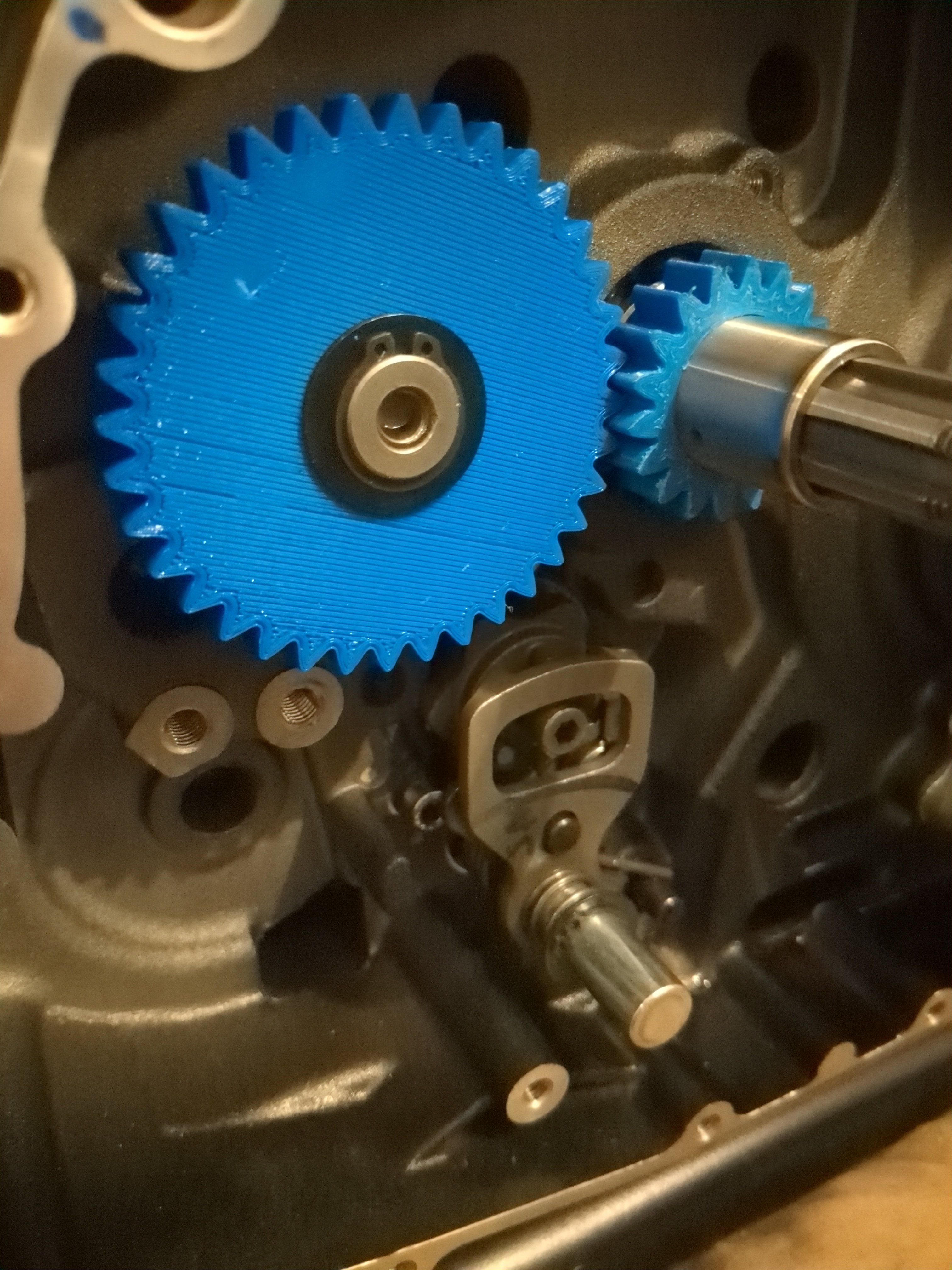

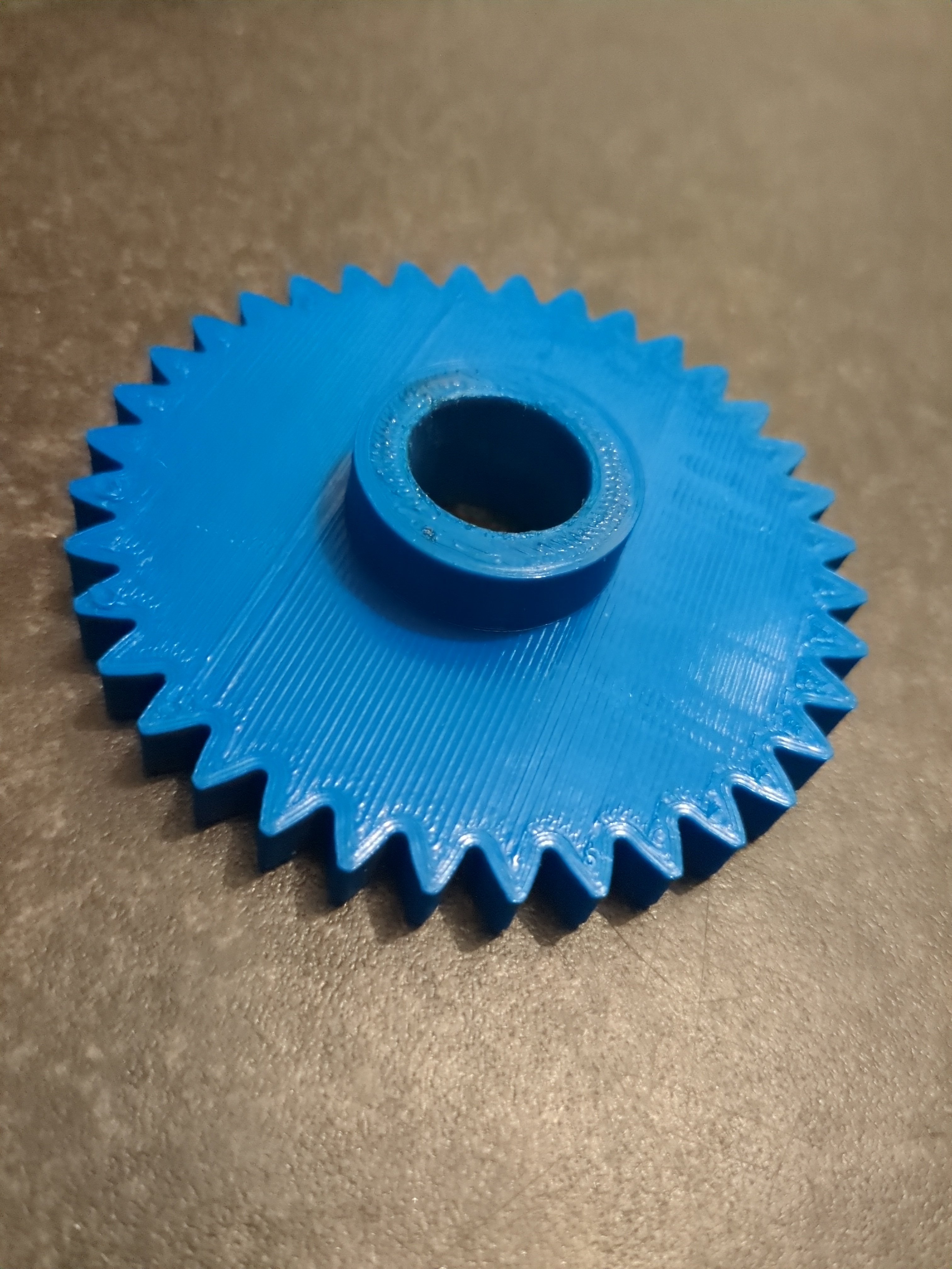

A quick update on the current state of project kickstart:
1. I updated the idle gear and clutch hub gear design and did a reprint. After mounting the parts and taking measurements, i am pretty sure the idle gear is very close (if not ready) to production stage.
2. The kickstart mechanism (from bullet/continentall GT?) is very old skool, simple and probably bulletproof (no pun intended...). I am pretty sure i can make it work in this design. They only drawback is that the pawl makes a clicking noise when the gear is turning (which is all the time when the engine is running). The gear is mounted inside the gearbox on UCE engines and thus much more isolated. The good news is when i mount the pawl on the downside it will probably run in oil because it will level with the oil in the clutch cover. The alternative would be a ratchet mechanism which is a bit more complicated to fit.
3. The kickstarter shaft is definately not the same diameter as the bullet version. I am still tinkering with it but i am almost sure RE had a 16mm shaft in mind. Luckily 16mm kickstarters are plenty available. I ordered one from my favourite chinese supplier and its definately in the right direction.

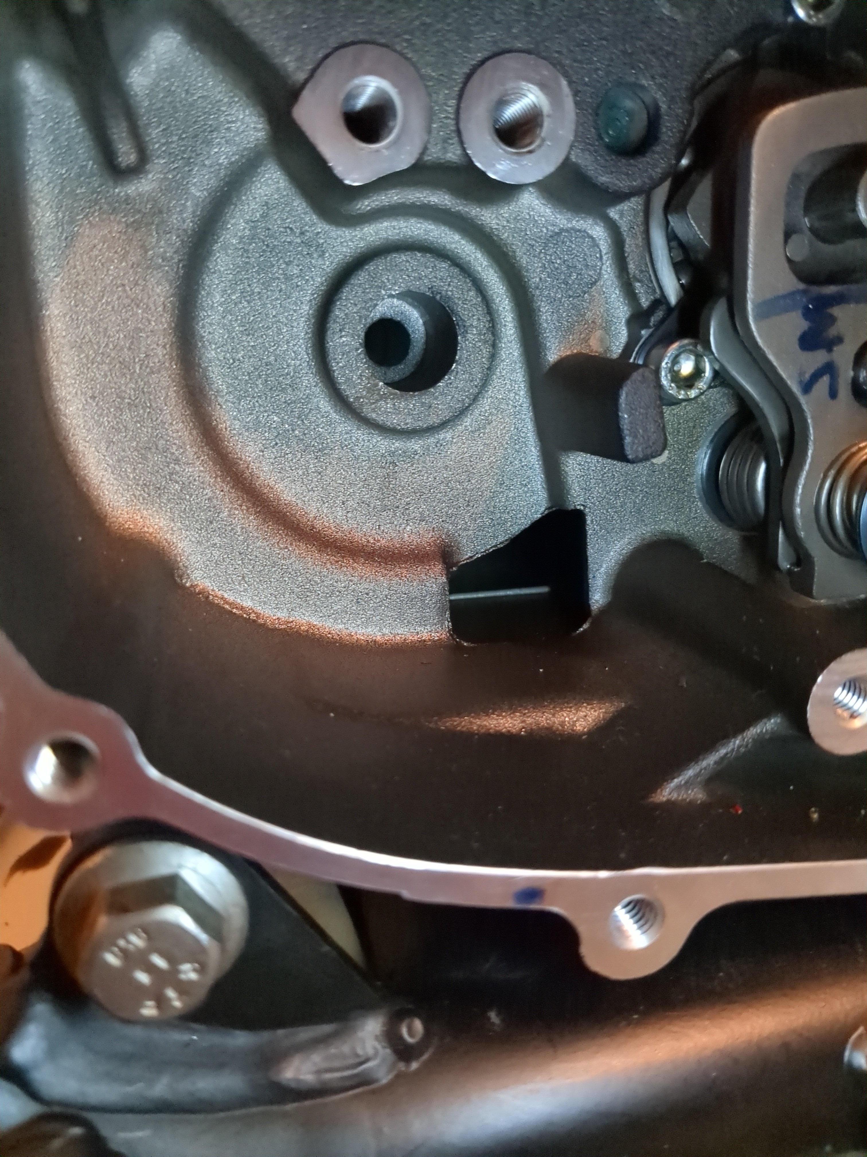

4. Which leads me to the mounting of the kickstarter shaft in the crankcase. The surface of the hole where the shaft is placed, is covered with engine coating. It also appears a bit conical.(around 15mm) I think RE ultimately would have reamed this hole to the final dimension(16mm...) in the production proces. For a one off item i would use a hand reamer but for a series this is probably not the best solution. Fitting a bronze bushing could be an option.
At this point i am 95% sure this project can be realized. Some bits are still vague as to how RE it had intended, but it will come around eventually.

Having the Case Machined to accept the Shaft and a Seal is going to problematic I fear.
Hopefully I am wrong,
