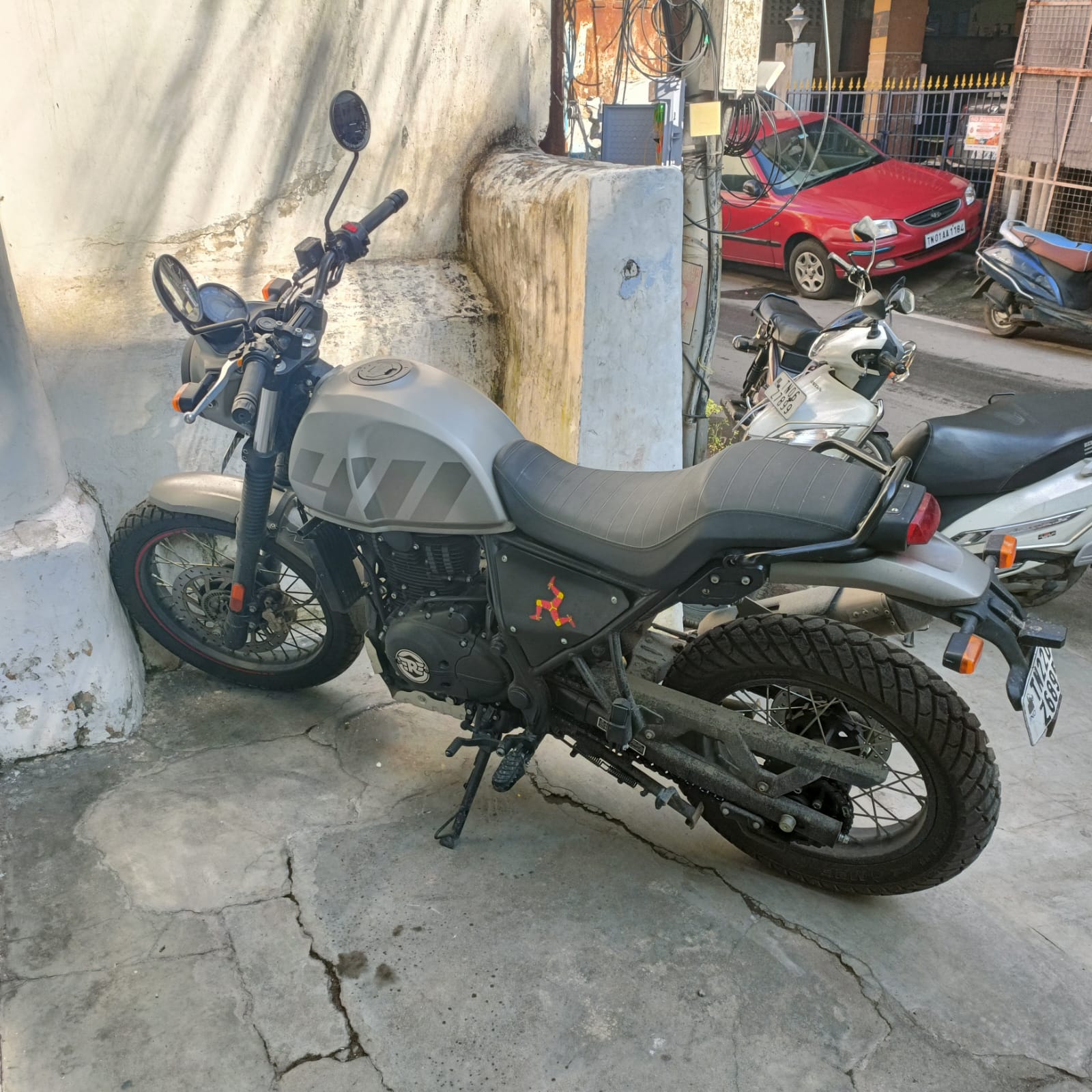

I'm not that tech savvy, will try and learn to post pics and stuff -- just tried my first photo hope it worked
The pic looks just fine. I meant a link to the Hitchcocks page.
