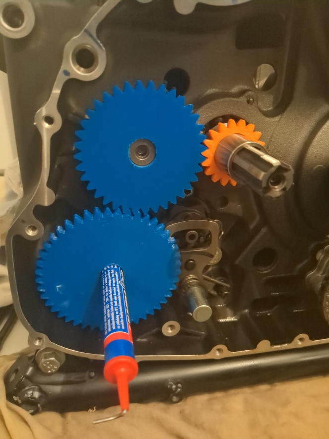

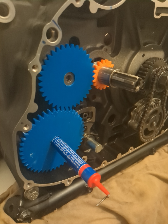

I've been working on the kickstarter for the himalayan and i might as well give you an update.
I made a drawing for the setup:
https://geargenerator.com/#900,350,...87234042553191,4.7,27,-105,0,0,0,0,0,1,3,1904
And then made some prototypes with 3D printing.
I think it's definitely a proof of concept.
Next will be investigating dimensions for the kickstartershaft and kickstarter itself.
Any news around the 6-speed conversion? I looked at it for a bit, It really seems like it was designed for a 6-speed, so it should be possible.
thanks

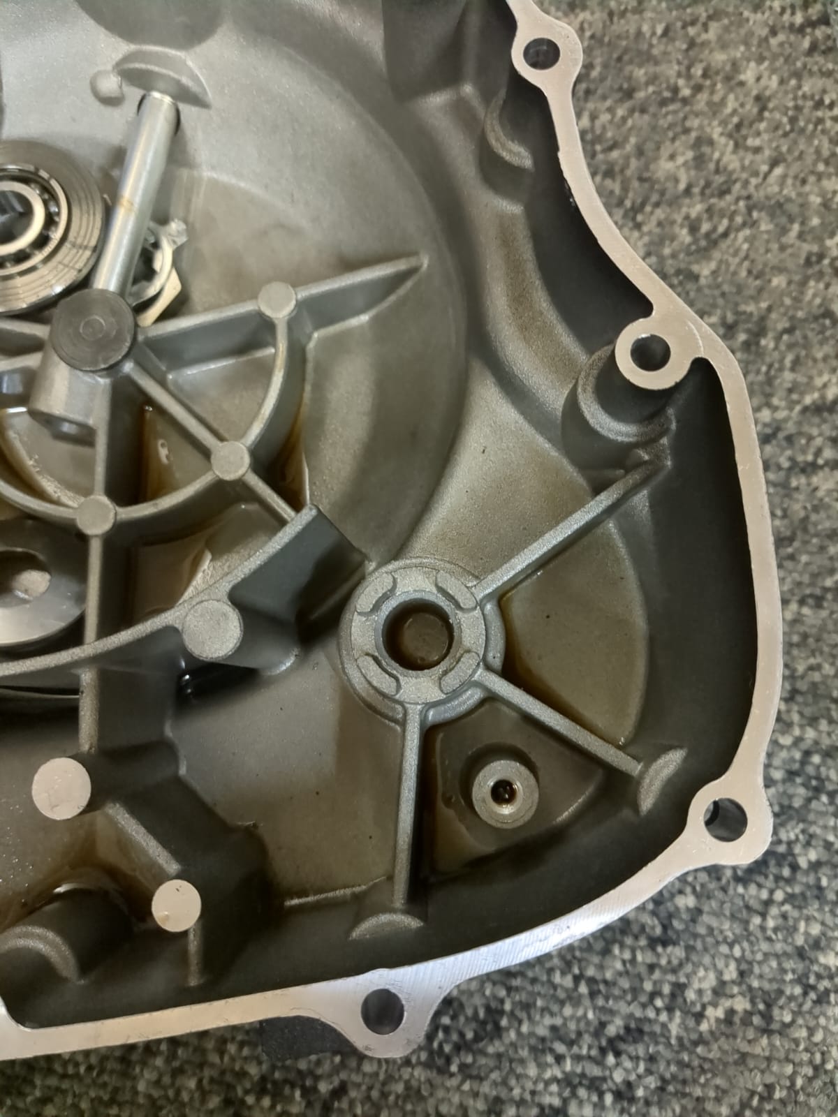

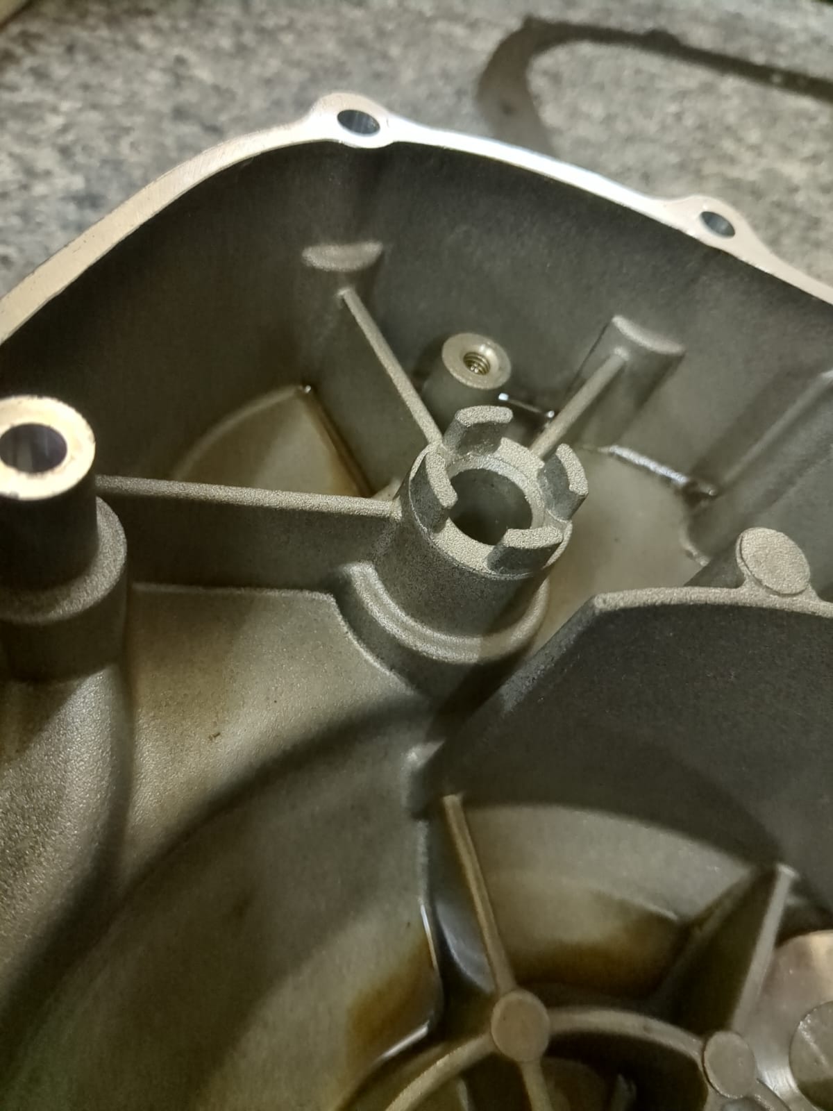

We will likely need a program that works out the position of the Shaft exit through the Case.
He just answered (I keep his name private as long as he does not decide to show up here by himself). There are other mechanisms involved, not just a few sprockets and a shaft. The cover wall seems not only thick enough - it has all the props for a shaft to go thru - almost as if in the last moment it was decided to leave the kick out of the design but most elements where already in place.

The Orange gear would represent the one which is normally mounted to the Clutch Basket, is it there on a Himalayan? I dont remember looking for it when I did the Plates. :rolleyes:
Downside of all this will be a couple of extra gears turning when its running, noise etc.
:rolleyes:
Yes, the orange gear is already on the clutch basket. It confirms my thoughts that it was all pre-designed by RE. Luckily one less sprocket to make i guess.

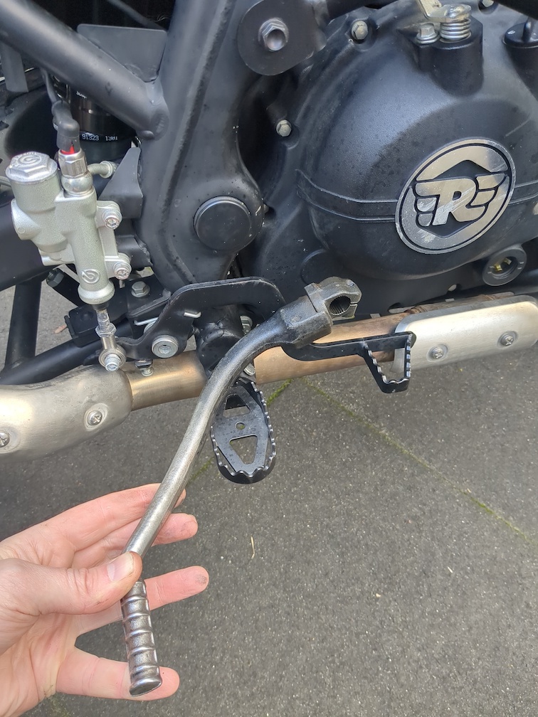

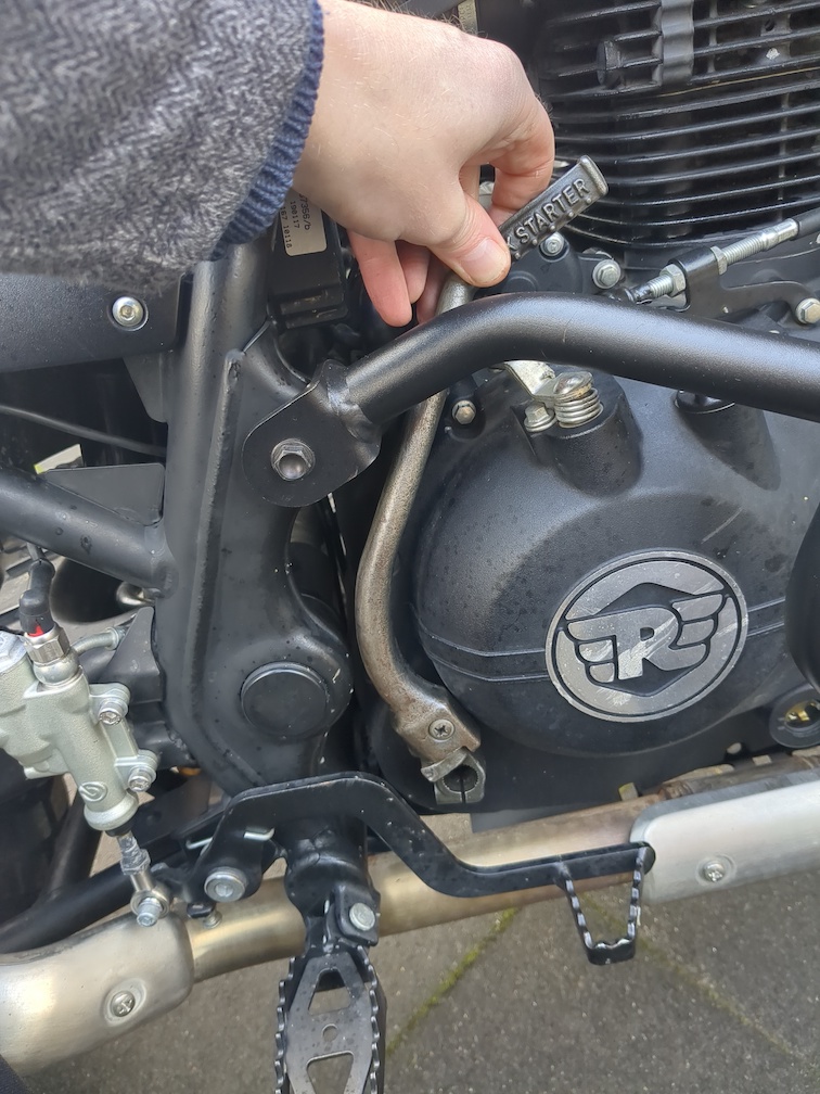

I have a xr250r from a friend around in my workspace for repairs and "borrowed" it to make some pics, because it is actually quite close to what we are aiming for. While doing this i discovered two more bumps in the road for this development:
- Having a Givi engine guard blocks the route of the kickstarter turn out.
- the brake pedal should be relocated to the backside of the frame (most off-road bikes i know have this, why RE put it on the outside is beyond my comprehension...). This shouldn't be that difficult but the brake pedal needs some modification.

Lever is a Good fit shape wise , the Mechanism in the Pillion pegs could provide your answer in a Fold Up Peg.
Get leg Guards from Sam and ditch the Givi's :unsure:
