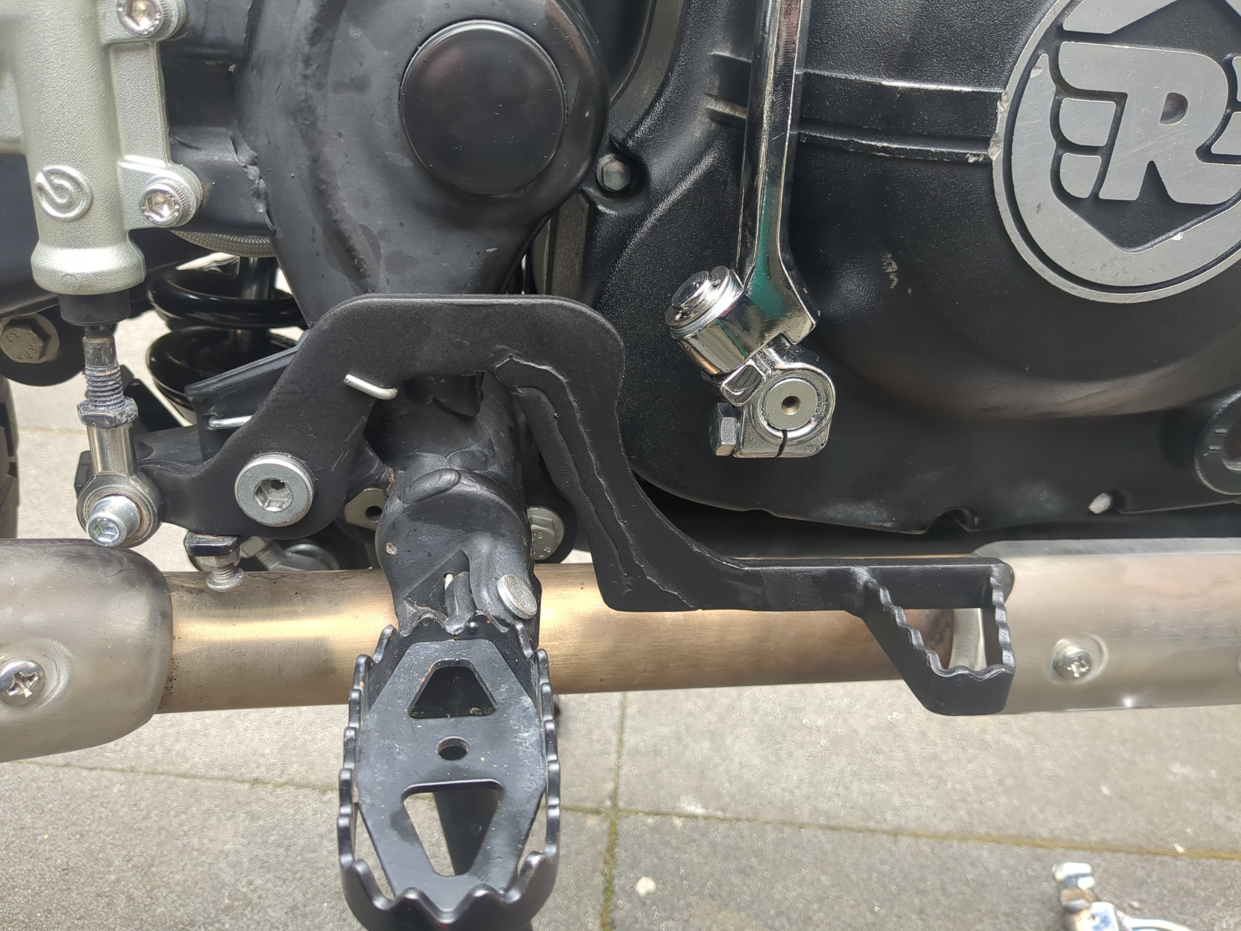

Oh, yeah number 11. The brake pedal has to be modified/refabricated, to make room for the kickstarter.

After an afternoon of fabricating i came up to this frankenstein result (i btutchered two chinese kickstarters together) which should come close to what RE had intended. It has about the same length as the Bullet kickstarter in the video. It clears the footpeg when foldeed up.
Its quite long but doesnt hinder my leg when sitting in riding position. The quality is questionable but i hope it will last for some time so i can test it out. I have already ridden a few 100 kms and the gears inside didnt expolde yet so thats a good thing....
