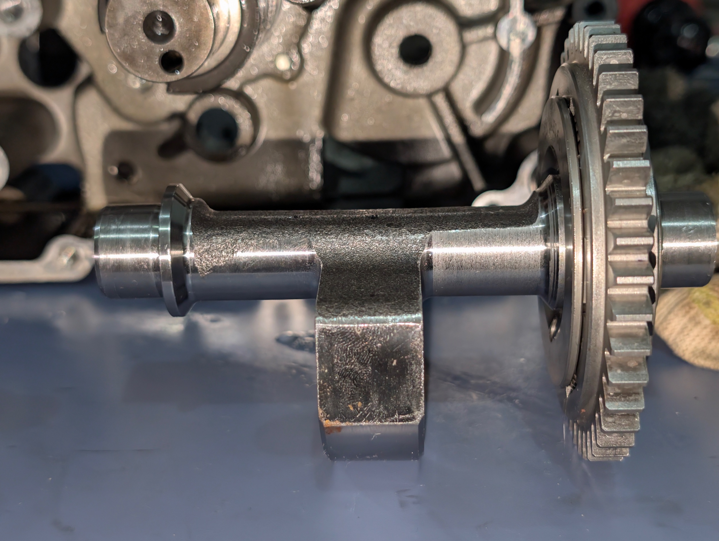

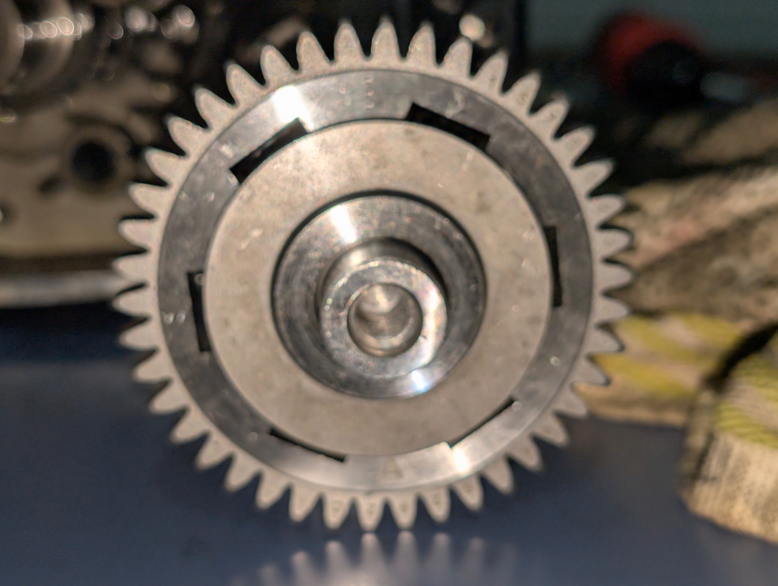

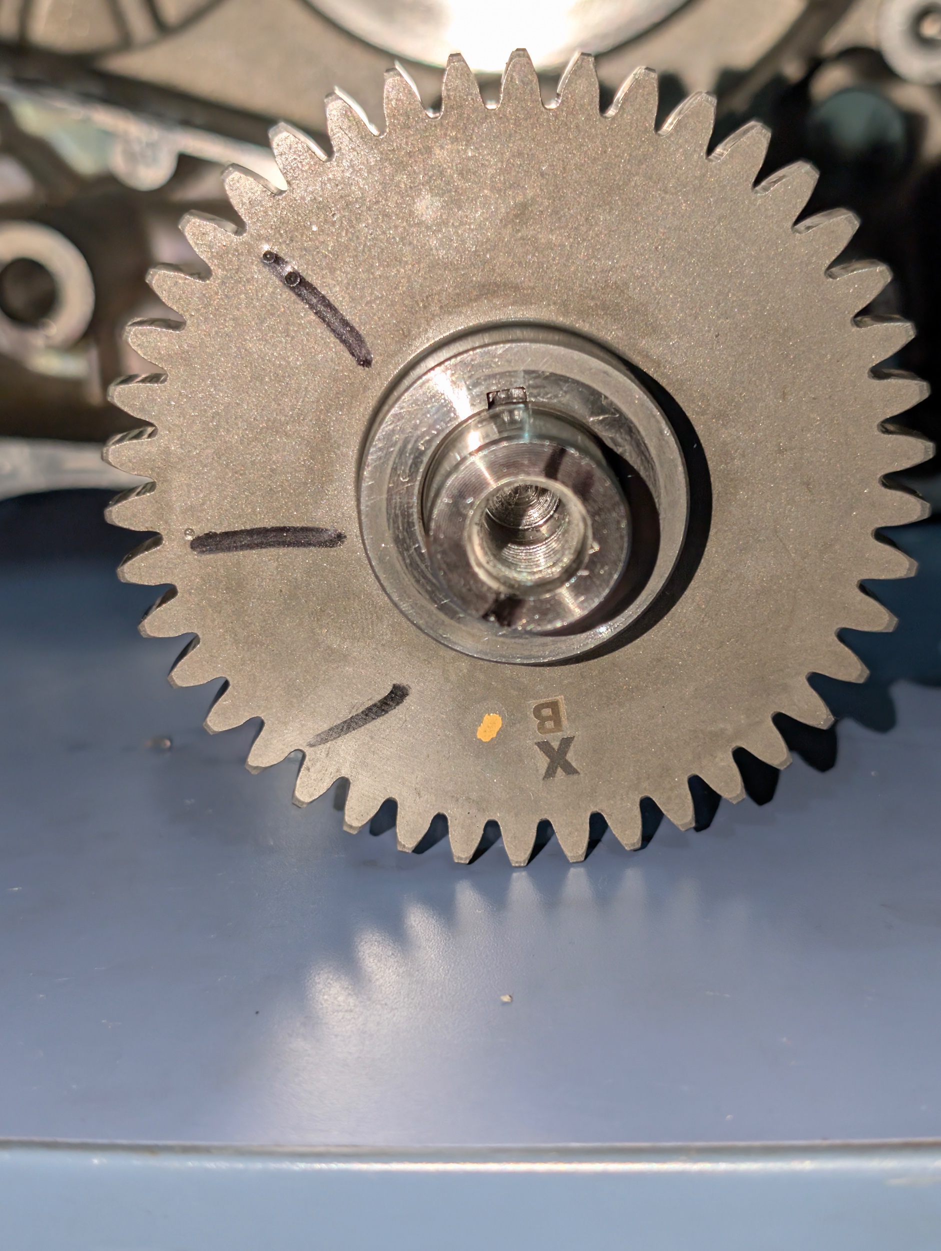

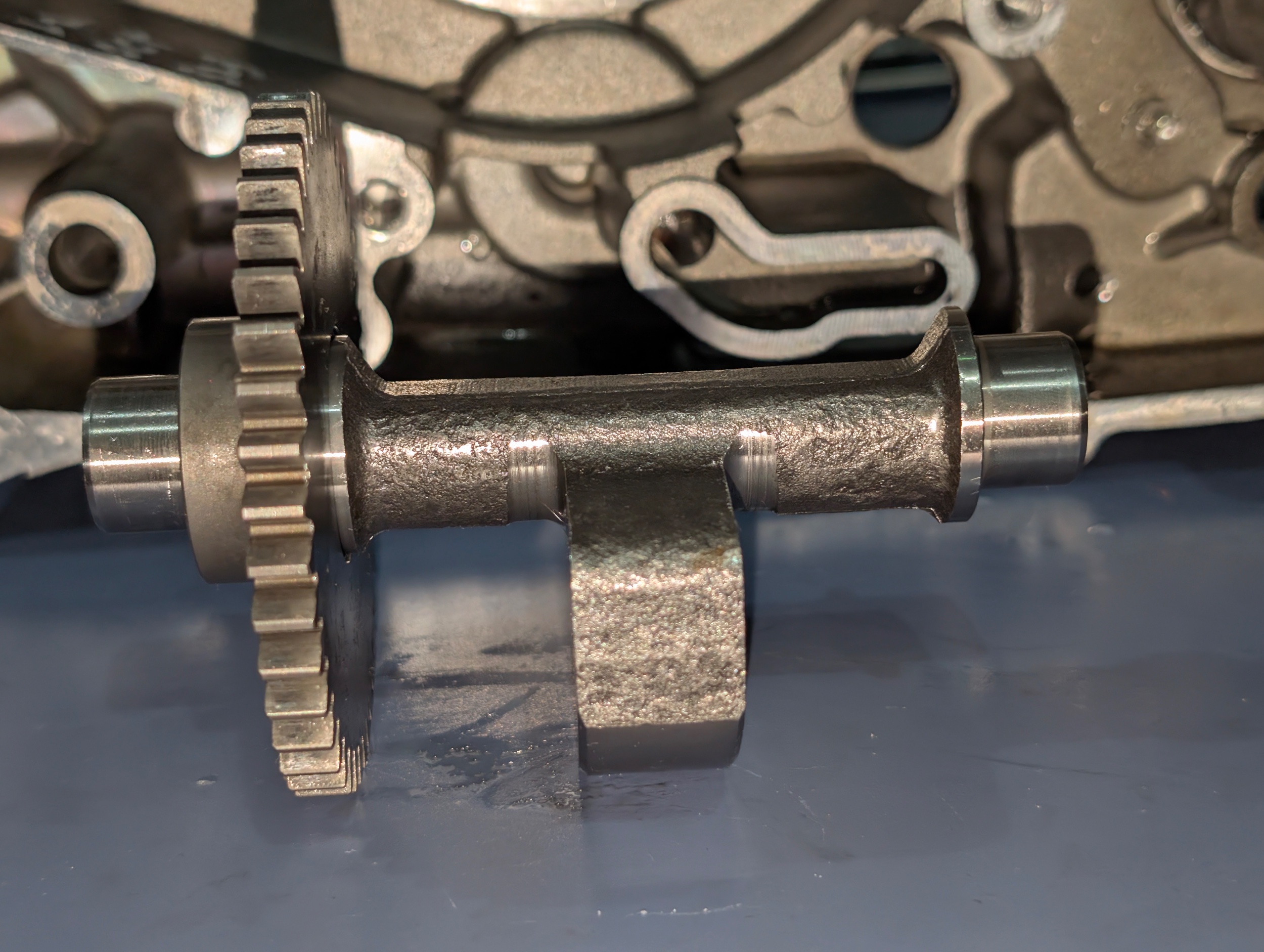

The balancer I got has a spring loaded gear on it. The one in the original bike did not. The difference is MASSIVE! My bikes vibrations and noise are at normal levels now. The bearings in the bike were not the correct bearings either. They placed "Shielded" bearing in the case without the shields on them. I replaced them all with the correct SKF bearings. Shielded bearings are typically greased and sealed in the factory, they are not the same as unshielded bearings. Engineering wise, not at all.

The crank balancer pulley difference

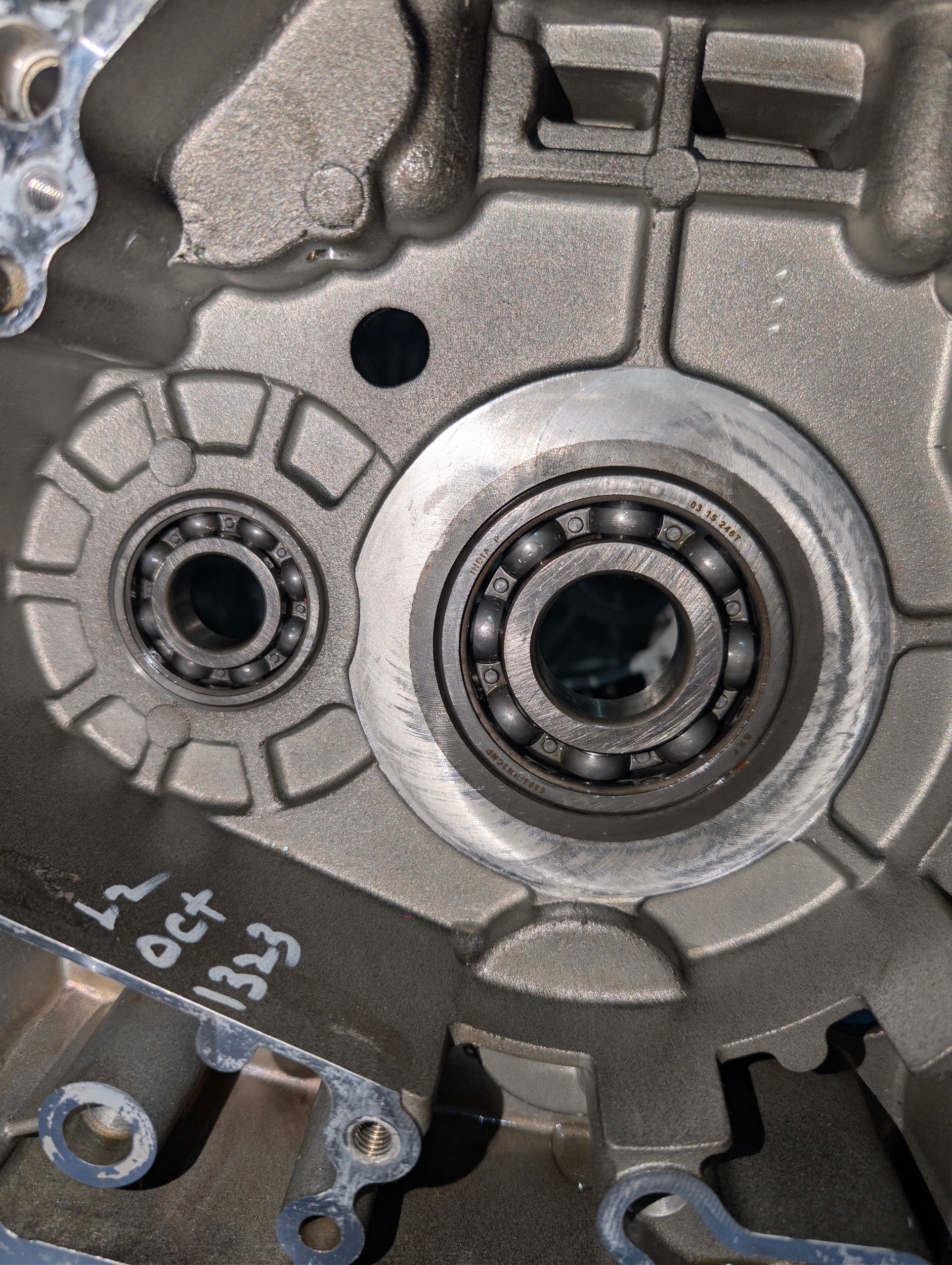

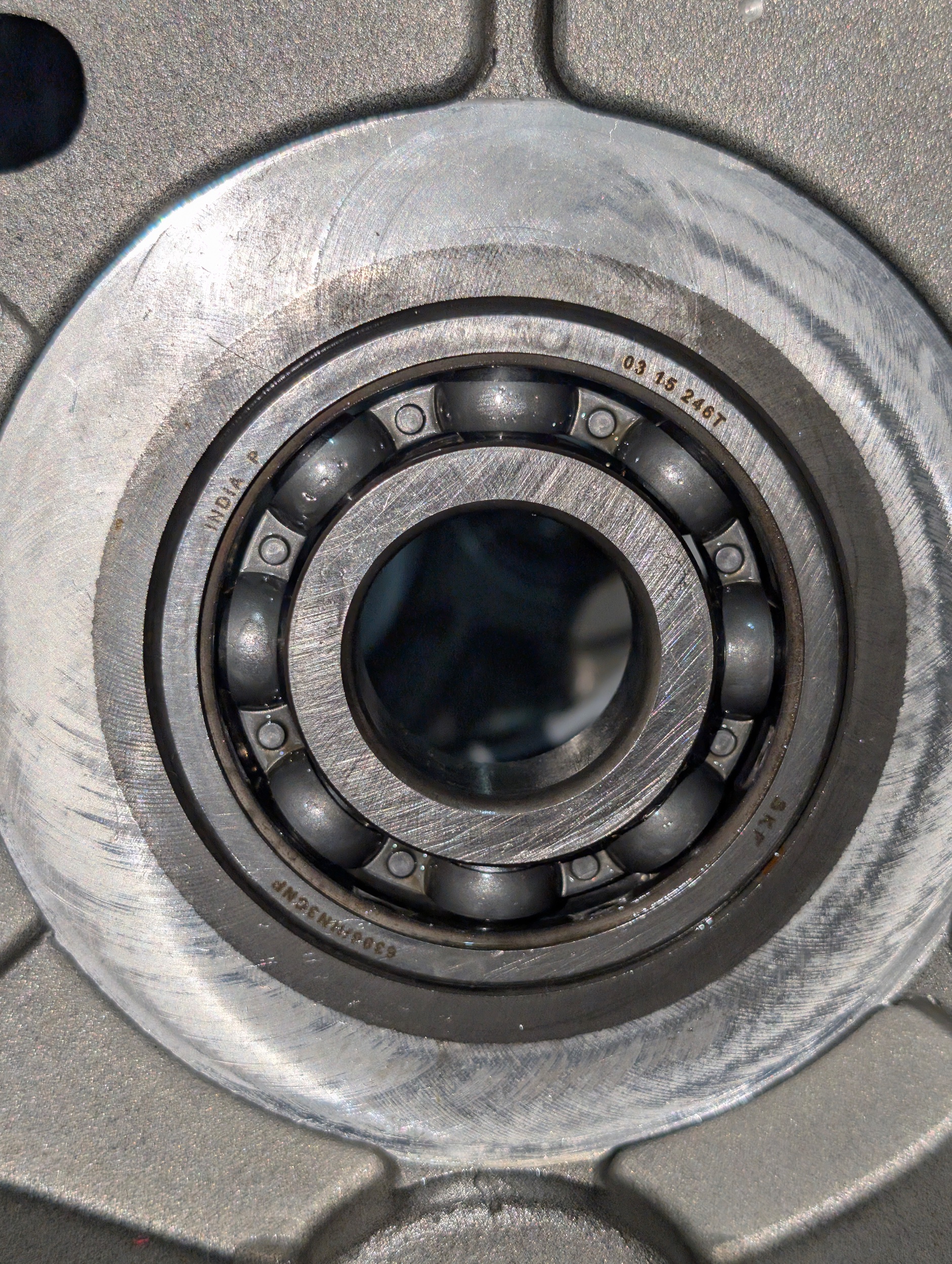

The bearings still in the crank case before I pulled them and replaced them with the correct bearings. NOTE the numbers on the bearings. Do a little deep dive into bearing engineering and you will find the numbers after the / are NOT the correct bearing engineered for this use. This is a factory mistake that isn't talked about on the internet. I researched the engineering specs deeply through the manufacture themselves SKF. I put in the explorer series C3 bearings manufactured in italy. Terrible mistake RE made and will probably NEVER admit. This would recall A SHIT TON of bikes sold in that era.
